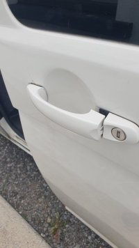

Loose external sliding door handle
HerdyT6
Hi all, the external sliding door handle on my t6 is very loose, 5 times out of 10 pulling the handle doesn’t actually open the door. Seems whatever retains the handle to the bodywork is broken/loose - anyone got any advice or remedies please? Tia
You will have to take off the inside panel, from memory when I fixed a mates handle that had come lose there is a screw you have to tighten which pulls the handle in tight. Search YouTube there’s a video on there showing how the handle comes apart

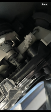

This photo might help, it shows the handle mechanism from the inside, it doesn’t show the screw you have to tighten though. On my mates the gold pin had come unseated

Just had the door panel off, the gold pin is missing completely. Couldn’t find it anywhere in the door card, fingers crossed I can buy the pin without the whole mechanism
my mates handle has come loose again so next time i think i will put a small blob of mastic to hold it in position, yours must be in the door somewhere

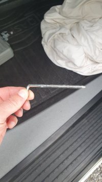

Can I bugger get hold of that pin, nightmare. It’s not in the door & doesn’t seem to be available on its own. I’ve actually got a spare round Allen key that I think will work when it’s cut to size….for now anyway
Good luck, let us know if you manage to fix it
Job done
Didn’t use the Allen key I was anticipating, too big. Funnily enough I had one of those cheap crappy Allen keys that come with flat pack furniture lying about. Went straight in, clipped in nicely, and I’ve put a blob of silicone on. Handle is tight and working like a dream. Hurrah!!
Job done

Had same issue with mine. It was the spring on the mounting bracket tha'd dropped out when the pin got dislodged. Fiddly job but doable with a bit of persisiance FB_IMG_1718565012980.jpg
Had same issue with mine. It was the spring on the mounting bracket tha'd dropped out when the pin got dislodged. Fiddly job but doable with a bit of persisiance View attachment 246410
Hi I have the exact same issue but I cant seem to get the black part of the lock (in front of this from inside the van? After taking out the 3 Torx bolts the unit wobbles around but it appears that something else preventing it from coming out maybe the key lock barrel. Found the spring in the photo in the bottom of my van door.
So you have to loosen a screw on the inside to get the barrel and handle off, then there’s a small screw on the outside under the handle you have to remove before the unit inside will come away. The rain catcher is just mastic on so you can pull this away to make room to remove the unit
