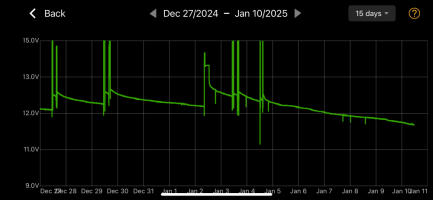

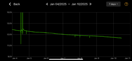

At this time of year, particularly when the weather gets cold, I get a low vehicle battery warning from my MetaTrak tracker app about once a week. I am aware that the tracker itself is the likely cause of the battery drain and that the resolution to this is to drive the van more often (mainly driven at weekends) or invest in a trickle charger set up. Not an issue during the summer.
However, my question relates to the impact this low battery warning has on the electrics control panel screen in the van. Please bear with me on this as I’m not blessed with great technical skills or an understanding of electronics.
I have a Sargent EC700 Power Control system fitted in the van. When I get the low vehicle battery warning via my tracker app, the control panel screen also starts to flash. When it flashes none of the buttons on the screen work. The only way I can seemingly get the screen to stop flashing is to plug the van into a mains source via the EHU, flick the isolation switch on and off on the power supply unit and leave it for a few hours. Just flicking the isolation switch on and off on the power supply unit alone, does not stop the screen flashing. I’m surprised the control panel screen is linked to the vehicle battery as I’d have thought it would run off the leisure battery.
I thought that if I drive the van it might generate sufficient charge to stop the control panel screen flashing - but it continues to flash and I get a beep every 9 mins or so. It may well beep when I’m not driving it as well but I’ve not checked this.
So my main question is - is there a better/quicker way to reset or stop the control panel screen from flashing?

Is this just the starter battery?
Have you got any leisure electrics?
The starter battery should last at least 2-4 weeks, even with the tracker etc.
The start battery may be on its way out and not holding a proper charge?
Seemingly so. I only get the alert when the vehicle battery is low and the leisure battery levels always seem OK when I check them on the control panel screen. Don't get why the vehicle battery getting low causes the contol panel screen to flash. I wouldn't have thought the two were connected.
It may well be the case that the vehicle battery is on its way out, but just wanted to check possible alternatives before switching it out. Van is due in for it's service later this week so will ask them to check the battery when it goes in.

If you are getting frequent alerts I would give strong consideration to moving the power supply if you can. A 75AH starter battery charged to 80% by stop start will only give around 23AH to 50% charge (which you should aim to keep above) whereas a 110AH leisure battery will give you over twice as much at 55AH and will generally be more tolerant of such discharge.
If you are dropping your starter battery below 50% on a weekly basis then those are the unfortunately ideal conditions for quite rapid aging of your starter battery.
I'd worry more about the frequent drains rather than how the EC700 reacts to them.

Fair enough. Thanks for advice. Will ask about the state of the starter battery as first point of call at service later this week. Beyond that will explore feasibility of switching the supply.

When weather and light (and work!) allows I’ll be looking to sort the connection on the negative terminal. Turns out it’s not the tracker as been back to the fitter of that and they’ve confirmed. So who knows what it is?
