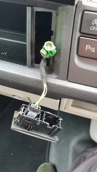

Hi all, I have a new T6 well 2018, new to me. It has no usb in the dash, reading on here it may have been used in the head unit, but unsure how as the cable and connector is still there and unused. Any thoughts on if I can simply buy the usb socket?

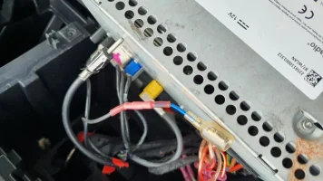

Theres also a few unused connectors behind the head unit, assimong these are old head unit connections? See pics

The other end of the usb cable is connected into the back of the headunit (the yellow plug) so putting a new dash socket it should hopefully get it working again if the wiring hasn’t been messed with too much

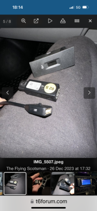

Here’s a couple of pics I took when I wanted to get the USB working after fitting a pioneer head unit. They might help.
The big square plug with 02 S on it is the original USB that clips into the trim.
The other one you see was from new head unit.

Perfect thanks. You don't happen to have the original usb to hand to get the part number do you?

No I had to open it up to fit a new bit that attached to my new head unit.
I will pop it back out tomorrow and take some pics for you. Will also have a look to see what the original wiring to it looks like.
