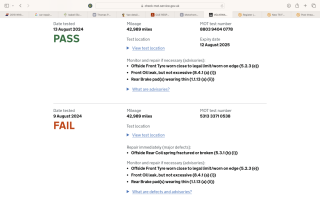

Would anyone be concerned by this MOT history. Van is 2018 and first MOTs were a pass. I'm a little suspicious about a broken spring and thin brake pads at only 42K? Can a modern engine be clocked?
Broken springs = common and been rectified (would probably check both had been replaced!)
Front Oil Leak = probably crank case oil seal, known issue, mine was the same. Now MOT item and unlikely to be excessive. expensive repair though
Rear brake wearing thin .... just a warning to monitor. mine was about the same at that mileage, probably did another 10k before I eventually replace disks and pads all round, not expensive hit and classed as consumables
remember these are not fails just "keep and eye on things going forward" or attend to now if you can

Springs can break at any time I guess and I don't think it'd be unusual for worn pads at 42k miles - especially as the amount of wear only warranted an advisory, not a fail.
I'd be more concerned if those advisories were still present now, 6 months after the MOT. That would indicate to me a less than ideal level of maintenance and that the owner couldn't be bothered to adequately prep the van for sale.

Other things, all fine from my eyes - a broken spring can be hard to see sometimes, depending where it's broken.

On all 3 of my Transporters rear brakes have worn faster than front so wearing think at 42k is plausible. Easy to check, tester might just be covering themselves/incentivised to change them.

Oil leak, most likely crank oil seal. Lot's of info on here. Mine weeps a bit. If not excessive not something that would concern me. Again easy to visually check if excessive and needs rectification urgently.
In regards to mileage correction yes surprising easy. The tool to do this vehicle is under £200, readily available and easy to use. If it's a DSG auto then that has a separate TCU which is hard/more specialised so a thorough scan will show if ECU and TCU match (there should be around 3-5k miles difference in values for these).
