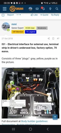

Terminal Block with Preparation for MFCM.
This bit may be under the seat for additional leisure battery?
Post a few pics of the electricals under the driver / passenger seat.
Eg...
The functions are basically as described, you get a slightly larger battery so it has increased capacity for powering stuff, you get a higher capacity alternator so it is capable of supplying more current to recharge your onboard batteries or power 3rd party equipment and finally the terminal block is literally a set of connections that output a variety of things from the van like voltage/lighting functions/engine run signal etc
The terminal block is designed to provide a single handy connection point for conversion works after manufacture and will be mainly utilised by companies converting the van into an ambulance or an RAC truck or a delivery van etc etc etc, theres not much that would interest an end user there other than an ignition live/engine run signal possibly ?
I ordered my van with the interface under the passenger seat. It allows for an easier installation of the VB air suspension & as you say, the engine run signal is handy for B2B chargers. I think it was about £90 as an option on a new build, so a no brainer.
IIRC on the T6 there were 2 or 3 different options for external interface connectors but I’m not sure what variations there were for 6.1 ?
