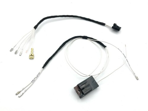

Yes all done and installed and working well, my final harness was actually a kit to modify my non multifunctional harness...it worked out the cheapest option and included all the additional wires that are needed in addition to the wheel which you normally have to buy in addition to the wheel harness.
I bought this and would recommend it.
Hi sorry to Hijack, did this loom upgrade kit come with instructions? do you still have them? I have been looking but can't find the pinning info anywhere.
okey dokey, no worries :) , I have e-mailed many of the sellers of these looms but not 1 has come back to me.
