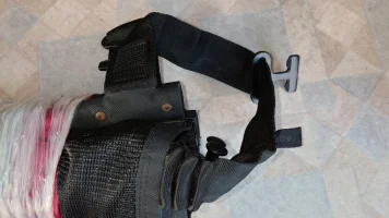

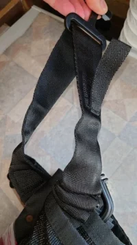

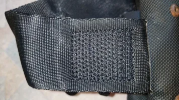

The bottom mounts are a very specific type of elasticated webbing inside tubular non elastic webbing with a specific tab to pull down to tension then while you position the T hook.
It might be difficult to replace that with something else @TJH1985 - the mount points are extremely heavily sewn for strength.
