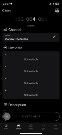

Regarding coding. I think I have done it but I need to check on OBDELEVEN. The screenshots on a guide I followed were totally different to what I had on mine. I was going to post about it when I got chance.
I’ll try and check and post later this evening.
So this is the screen I came to on OBDELEVEN. I changed the last six digits to the date installed everything else I left the same. I removed a 75 or 80ah battery and put this 95ah in its place.
I feel I haven’t managed to get to the correct menu but I followed the steps on a thread on the forum.
