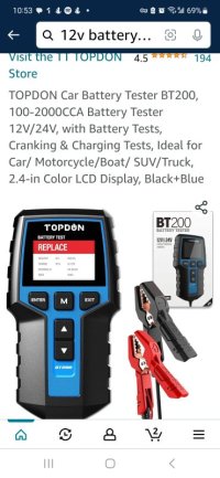

Most car garages have battery testers.... Eg Halfords will test your battery for free..... Or you can buy a battery tester your self.
Like this..
