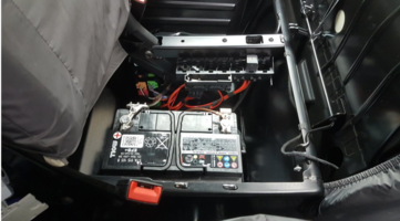

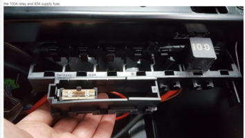

OEM setup on mine: (under passenger bench_)
(Note: it will have a rubber cover over it . . . .)
more info here:
this is with the rubber cover back on . . . . : https://www.t6forum.com/threads/sto...r-for-leisure-battery-or-not.6954/post-151280
View attachment 117274View attachment 117275
more info here:
Thank you so much @Dellmassive ! Thats a great help. (sorry, missed the notification for this post)

I have done but he’s got a double bench seat and I’ve got 1+1 so not sure if it differs. I’ve currently got a T6 with a double bench and it’s under there as Just the same as @Dellmassive. Has anyone else got twin captains up front with the battery option?
The second battery is under the passenger single captains seat too
