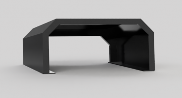

Ordered an Aguti H210 swivel (-3cm lowered to accomodate swivel plate hight) and 2KW Webasto which should fit under seat according to these drawings I found in a thread in the German forum.
