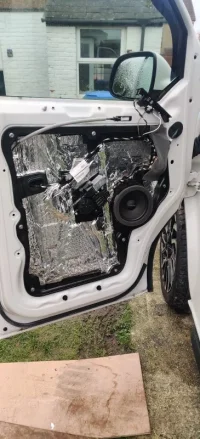

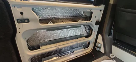

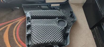

I have a CamperKing van myself. I bought mine back in March this year and although I wanted a van fully insulated and sound deadened on my wish list of things to have, I decided their were more positives to buying from CamperKing than negatives, so I overlooked the fact it wasn't insulated. I've literally finished sound deadening and insulating my van this week. Truth be told, I really enjoyed doing it. I did the side door, the rear quarter, the tailgate and the 2 front doors. It's impossible to get behind the kitchen without taking it all apart, which I'm not prepared to do! It was fairly easy to do, although I did cut my hands up getting to the deeps of the panels.
The final results.... It's like chalk and cheese! The van is SO much quieter and gives it more of a car like sound when closing doors. Probably sounds silly, but I'm so glad I did it and trust me, I have no DIY skills at all :) You can talk to the people in the front and the people in the back without having to raise your voice, and a lot of the little annoying rattles seem to have gone as well? Would definitely recommend doing it. I can provide a list of products you need if you like, but like I said before, would 100% recommend you do it...
Thanks for getting back to me like you I am very pleased with the looks of the van and inside is very modern. If you don’t mind a list would be very useful and I am looking forward to doing this given your positive feedback. This forum is great best wishes Chris
Sure, no problem. I'm no expert, and I'm sure people will say "you don't need to do this" or "you should have done that", but this is how I've done mine and I'm really happy with it...
So as mentioned previously, I did the sliding door, the back quarter, the tailgate and the 2 front doors. In total I ordered the following:
3 x Sound Deadening Dodo Mat DEADN ® Hex 20 Sheets Special Edition Car Van 4x4 - Sound Deadening Dodo Mat DEADN ® Hex 20 Sheets Special Edition Car Van 4x4 | eBay
*used this for all the panels
1 x Camper Van Insulation Foam Dodo Thermo Liner Pro 6mm Foil 3sq.m Sound Proofing - Camper Van Insulation Foam Dodo Thermo Liner Pro 6mm Foil 3sq.m Sound Proofing 5060675880456 | eBay
*used this for sliding door, 1/4 panel and tailgate
2 x Dodo Mat Acoustic Liner Sheet 15mm Car Soundproofing 100x50cm Self Adhesive - Dodo Mat Acoustic Liner Sheet 15mm Car Soundproofing 100x50cm Self Adhesive 5060675880401 | eBay
*used on 2 front doors
Can't recommend the Sound Deadening Shop enough. I ordered a fair bit from them on different days, and most of the time it was free next day delivery.
2x Insulation Rolls - https://www.diy.com/departments/diall-insulation-roll-l-6m-w-0-37m-t-100mm/3663602481812_BQ.prd
I also used aluminium tape to put on all joints, joins, seals and small gaps (probably over kill!) and got some spray glue to keep the insulating foam in place. A roller helps to make sure the sound deadening is pressed firmly on the panel, but I also used a long wooden soon for all those out of reach places!
You'll also need some trim tools to remove the panels and then some replacement clips. I snapped a few when pulling the panels off, they aren't expensive so I just replaced them - Halfords Trim Panel Clips | Halfords UK
I'd also recommend, whilst you have the panels off to vacuum the bottoms out. I like Camperking vans, but because they are mass produced I've found the attention to detail is somewhat lacking! I found the odd bolt, screw, rivet and just general rubbish in the bottom of the panels.
I think that's it, but If I think of something I've missed I'll let you know and if you have any questions please ask :)
