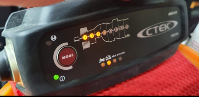

here is the results from the CTEK.
2 days later the charger is still running the loads . . . similar as the Victron unit.
here is the BM2 plot.
i managed to get the charger to restart the cycle . . .
but only after throwing a massive load at the inverter, causing a volt drop . . .
the charger detected this and restart the charge cycle after the battery volts dipped below 12v.
at that point the cycle restarted. . .
that shows that the CTEK smart chargers can be used as charger/power supply when on EHU.
test end - definatly this time.

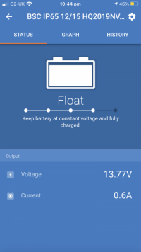

Well I've now got the victron fitted, dont have the fridge plugged in yet but will give it a try next week!
Out with the old

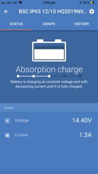

and then when the victron was plugged in
And then after a few hours
