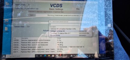

I'm having no joy. Service regeneration duration doesn't start to count. It says hold brake and accelerator pedal and it sits at 1500rpm.
I tried a driven regeneration but that just times out.
Reactions: mmi
Obviously the exhaust temperatures didn't go up?
In the engine there seems to be also another counter for regeneration duration - probably need to monitor both counters.
A last resort would be to use an adaptation channel to fool engine to believe it got a new DPF.
VCDS > Select > Engine > Adaptation > IDE07903 Adaptation of ash mass to "0 grams"
This should reset also soot values (calculated/measured) to appropriate values to allow forced DPF regeneration.
