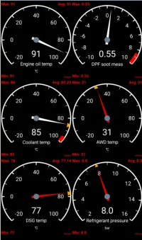

Live data ➕
Both can read/record live data:
OBDeleven - 100% coverage of data and 100% of controllers covered
Car Scanner only partially (as far as developer has managed) - of course can be complemented by user, as e.g. below
Allows to build dashboards to visualise data
