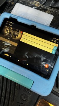

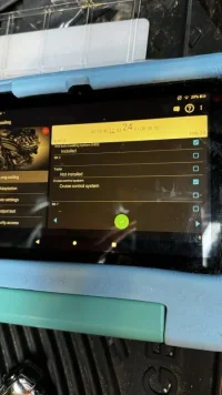

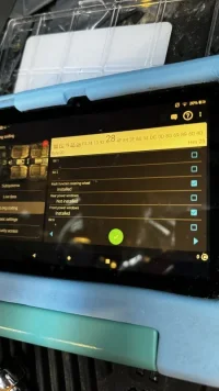

Please post a screenshot of where you are doing the changes.
I now have a glow plug light flashing

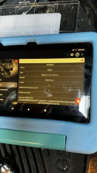

What's the fault code in engine?
So you did not have the cruise control before??
The engine was ignition on only - but not running?
Hi mate
No just a big standard plastic wheel no car on stalk etc.
Yeah ignition on only
Managed to remove glow plug light flashing but here’s some screenshots
