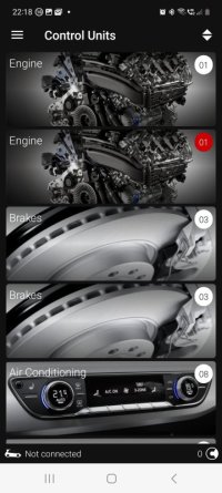

I am using OBDeleven and recently had to reinstall it. I now get multiple entries of each control unit (see attached screenshot) so I have 2 or 3 of each one.
Bizarrely for 01 engine module, 1 of the entries shows 0 faults, the other shows 1 faults.
Some modules appear twice, others 3 times. How can I resolve this?

Unfortunately still the same.
Bizarrely my van details were already entered when I reinstalled so data is being remembered somewhere
My OBD11 shows as OBDeleven VAG in th apps list.
Sorry my instructions didn't help.
will try and figure out how to get my phone to forget everythign about the app when its uninstalled. Appreciate your efforts.
