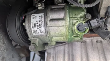

Had an engine light come up yesterday "oil sensor visit workshop" then "stop start error"
Looked under van today and there's quite a bit of luminous green fluid leaking from somewhere.
Could this be something to do with the Aircon that suddenly stopped working the other day ?
The luminous green fluid will be the refrigerant for the Aircon. They add the colour specifically to find leaks.
