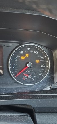

Afternoon all,
Just after some potential causes for the dash lights to all come on at the same time. I wouldn’t normally ask about warning lights - self explanatory. BUT a few came on together.
So, 300 miles in to a 500 mile trip to our holiday destination and I pull in for a rest. Van driving lovely.
Go to resume and ‘ping’ - ACC fault, ABS fault, stop start fault, tyre pressure sensor fault and driver collision fault. Van drove as normal to our destination - I just had an achy foot from not having adaptive cruise.
Get to our destination and turn off to go into reception…come out start the van and all warnings gone.
A couple days later (today) we go out for a trip and ‘ping’ all on again. Multiple restarts today but not going out.
Info to note: 2017 high line, DSG, 44k. No faults over the last month (since buying it).
I had a Westfalia 13pin tow bar fitted (professionally) two weeks ago.
I’ve changed the alloys over to genuine sportlines with new tyres.
Had new brake pads all round at VW just before I bought it (~1500 miles ago).
All running fine without warnings for the last ~1000 miles.
Any ideas? I wondered about a dicky battery. Possibly a wheel speed sensor?
I’m in France with Breakdown cover, but don’t know if they’d cover orange warnings - only red ones.
Any advice appreciated!

hi. Mines a 2020 T6.1 and i got all these warnings couple weeks back. I was in getting tyres and on startup outside the tyre place all the warnings came up. I let it run a bit and restarted again and all warnings were gone. I just informed the tyre place while i was still there just in case something had happened. 7 - 800 kms since and no warnings since.

Hi all, @J3AAY did you get this sorted? I'm going away at the weekend and just had this issue. It pings on startup and the error comes up saying no esc or front collision monitor plus the lights stay on. From searching on here it seems it might be an abs sensor like you say the garage told you. Can anyone advise how to diagnose please? Will Carista tell me which sensor is at fault on which wheel?

Yes, Carista or VAGCOM should help
That ABS light illumination is the same as my issue. What appears to happen is if you don't resolve it, there is a Chain reaction and glow plug light flashes, the speedo goes and the fuel gauge. Due to everything being informed by the ABS sensor on the inside of the spinning wheel
The solution so far - 3 visits to the garage. Visit 1. New passenger front wheel sensor replacement. 1 mile from garage ABS back on
Visit 2. More investigating think might be front drivers side sensor
Visit 3. Clean wheel, bearing and gap between the wheel and sensor
So far no lights

I reckon that's a wheel speed sensor.
