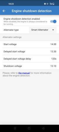

Evening all can someone have a quick look over my settings make sure it all looks ok please? It's a lithium battery.
Orion:
Then the battery protector:
Also the ignition live wire I have run from the factory 2nd battery relay, but am unsure about the connection on the Orion. Does it replace the jumper cable completely or does it go in with the jumper cable?
