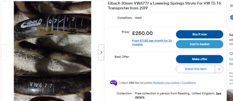

If you Google Vw677 then an Ebay add comes up with an Eibach -30mm lowering spring..,
Also, look at this Forum thread:
They are 100% -30mm Eibach lowering springs
Thanks for that, it would seem that I was expecting more of a drop than I received. In fairness I never asked what drop the springs they were going to fit would give, I just assumed it would be like my other van, which had -40mm H&R springs.
Also, the springs were not clean, but I suppose the dealer could have changed them the day before, (I dropped the van off the day before) & I think it did rain the previous day.
Obviously going off the numbers on the current springs on my van they are indeed -30mm Eibach items so I'll have to eat some humble pie now !
