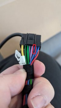

I've got an Alpine Halo 11 and I have just got round to installing a Fire stick into it. I cannot get the picture on the screen as it says its turned off for my safety.
I guess it's the parking brake wire. I've traced the yellow and blue wire from the back of the head unit this goes into my Alpine APF-X300VW can bus adapter and I don't know where it goes from there.
Does anyone have any idea what I need to do to either bypass it or connect it correctly.

The 300vw is the CanBus adapter, converts the can to an analogue 12v or ground .. cut the yellow/blue insulate end coming out of the 300vw and connect headunit end to ground or blue wire on the loom
on the Kenwood it’s a green wire
