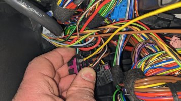

I'm trying to insert this repair wire into the T10 connector at the bottom of the E-box
In does not want to go into the connector, been at it over an hour now.
Never touched VW wiring before, complete novice. Are any tools required to insert a pin into the connector? Am I missing something? Or should it slot right in there?
Any help greatly appreciated
You need to remove the wedge that locks all of the pins in place first. The pinky-red bit on the face of the connector.
Then push your pin in, then re-insert the wedge lock.
Well there's an hour of my life I won't get back. Thanks for the help!
Is that snakes nest really how it comes from the factory?
