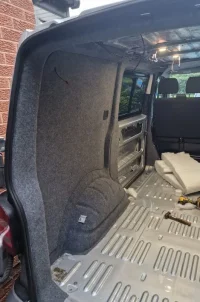

I've attached the photo of my carpet lining to show im not a complete spoon just this subject has annoyed me ha
