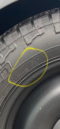

[edit - apparently the GGs ATs - or at least maybe GG AT3s - *are* 3PMSF marked]

Also I just had a check, those Falken tyres seem to have the 3PMSF rating.
