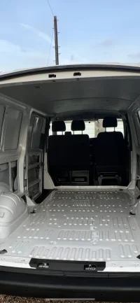

As per the other members comments depends personally I didn’t but I got mine to do the top and install my electric items lights heater and solar panel with internal chargers WhatsApp Image 2023-01-12 at 21.49.21.jpegWhatsApp Image 2023-01-12 at 21.49.21 (1).jpeg
They sorted all that out including relocating the lights for new including switches

The lights are held into the hole in the hardboard with clips. I partly pulled the panel out to peek behind to see where the clips are. I cheated and popped them out from the back.
The wires connect via a plug which you can pull out - it is dangling down in @Albel ’s picture.
