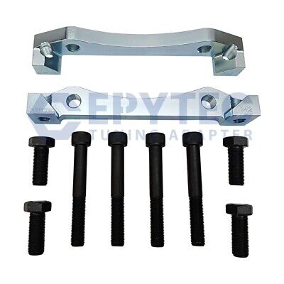

Went to install this kit earlier this week and the bolts issued to fit the Caliper to the carrier are wrong, sent m12 70mm and need to be m14 fine pitch 110mm so way off, also looks like will still need to space the Caliper further so brackets are not ideal, so far they have just not responded to messages so I would not recommend anyone buy there adapters
