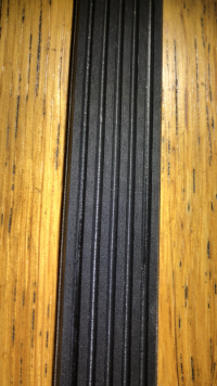

The belt was overhanging the tensioner by a couple of mm, and I took a photograph of it with a thermal camera and it was hot after 10 seconds from a cold start on the edge overhanging the tensioner.
The belt that’s been on for 2 months has been damaged by it slipping on the alternator, with polished parts showing on the valley parts of the belt.
