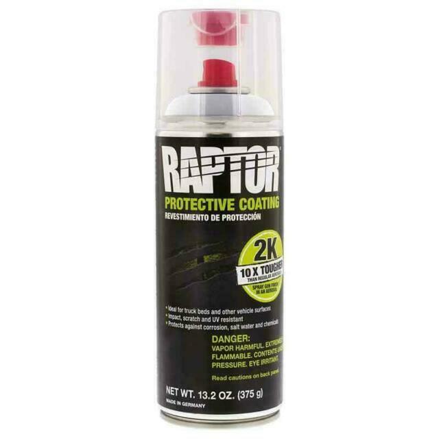

I have a-bar and round side bars painted with Raptor, applied with a roller on top of roughened and etch primed chrome.
I like the surface texture but it still chips. You need a pretty thick coat with Raptor and I think it chips due to being so hard. Could be due to the chrome basis but I think it would peel rather than chip if the basis was the problem.

Ok thanks for the feed back, I’m thinking of buying some Black Matt Trapezoid bars, and spraying them to add something a bit different, I’ll get a few coats on them
Make sure to have a proper mask and really well ventilated space when working with it. It’s the worst smelling paint I’ve ever used. Probably translates directly to toxicity.

Here’s a fresh photo of chipping after two winters. This is front a-bar, and being in Finland it’s about as bad as it gets - we have road sanding and lot of spiked tyres in use. The front gets lot of bombarding.
Should fix this summer, good thing with Raptor is that you should be able to just paint on top without any sanding, just cleaning is supposed to be enough.
And one more note of Raptor, it needs to dry a whole week without getting wet, might or might not be an issue

Thanks for the advice, yes I’d spray bars before fitting them so can leave undercover to harden off for the week, I’ll hang them up while I spray them so I can get all sides painted, I’ve got a carport canopy, so plenty of fresh air while spraying.
