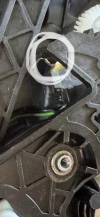

Hi all, I’ve worked out this issue, got it all working again faultlessly and thought I’d share my findings. Basically within the lock module there’s a tiny microswitch that tells the power door motors if the door is locked or unlocked. The power latching is a separate systems and thus the door would come open from the handle but not track back. The microswitch had slipped to the side and thus was not saying that the door was unlocked. Reseating this microswitch and all is back to normal and working fine.
You can see in the above that the microswitch level has slipped to the side of the small microswitch nipple. Microswitch pressed in = unlocked. Hence the door module was not aware of when the door was unlocked.
