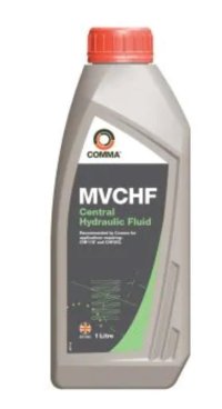

Is this stuff suitable for 2019 power steering fluid? Says it is on some sites but I’m not too sure as vw is 004 and this stuff is vw 002 something along them lines..
The viscosity is 0.003 higher and the cSt are the same. The major difference is the pour point temperature. This is 4°c lower, so I would expect this to break down sooner than the recommended valvolene/bag power steering fluid.
