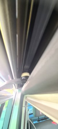

Hi, has anyone had any issues with the sensor strip above the top roller set?
I'm thinking that the reason I'm having 'Jump back' when the door is 1/2 way closed is possibly related to an issue with the upper strip in the sensor guide rail above the top roller?

Hiya, I've changed all the rollers including the upper sprung loaded sensor, the anti-pinch seal etc. All the channels are squeaky clean.
One thing I noticed earlier was that if I pushed up on the underside of the upper roller arm (with sprung loaded sensor) and the door closed all the way!! Maybe I need to adjust the lower roller arm a bit, to move the door up a wee bit.. or adjust the upper roller arm, if I can (to move the sensor closer to the sensor strip)?
