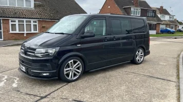

Here are a couple of snaps of my previous van and current van :cool:
