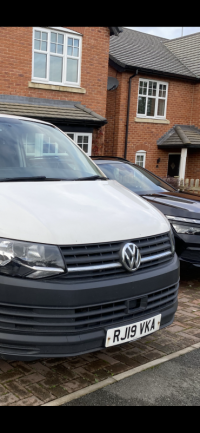

Does anyone know if this sensor does anything? I don’t have ACC on my start line model…or at least I don’t think I do. I’ve bought a colour coded bumper set but the grill doesn’t have a cut out for the radar sensor. Can I just install the new grill age in front of it or do I need the cut out? Thanks guys.
Even without ACC you will still have auto braking/city assist to stop you rear ending anyone
Ahh okay thanks Pauly. So I need to find a grill with the hole for the radar sensor then. Thanks
Yes, if you disconnect or cover it the van will have a fit !

Your startline front bumper is one piece. You can’t change the grill in it. Highline and trendline bumpers are different and the lower grill is 3 pieces and can be removed or swapped for gloss black.
I’ve got a startline and was hoping to swap the grill also.
Unfortunately it’s a no go.
