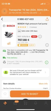

How much would HPFP cost me @DXX
No idea, simple enough to access, engine timing would need to be checked.
There are single element and tandem element type pumps, depends on the engine code.
Put your registration number into an online site and see how much the part is, maybe autodoc or similar.
