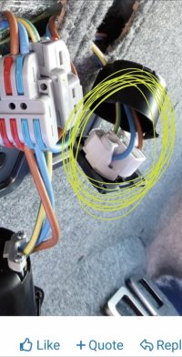

Completed the 240v in the van. Now it's doing my head in. RCBO fitted. Plug in and all tests fine. 240 at sockets. As soon as I plug anything in it trips. Tested all wiring. No shorts whatsoever. I'm wondering if it's the connection blocks I've used. I have used them before with no issues. Any ideas
Is the live and neutral, blue and brown not wired up the wrong way round on that socket?
Also how is the other one wired inside that black housing.?

Got a side and front pic of that socket?

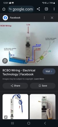

Used the connectors for Neutral and Earth. Would this cause the imbalance? Is there a better option bearing in mind the cramped box?
The PE earth needs to be separated from the neutrals.
You need L & N to go IN and OUT the RCBO.
The PE earth stays separate.
So the van chassis is eartherd to PE when connected to the external EHU.
So effectively I have to wire a Neutral and and Earth from the incoming EHU cable to the Neutral Out terminal on the RCBO?
No the PE earth stays separate
EHU N to rcbo N IN....then rcbo N out to sockets.
EHU L to rcbo L IN....then rcbo L out to sockets.
EHU E to E van busbar, E bond with chassis and E to sockets.
