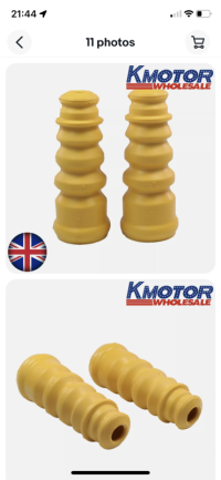

Have just fitted solows and after shortening the rear bump stops a little one of the rubbers keeps falling out and the metal bit that’s above it inside the tube has come away to. Not sure why as I cut them both the same length and the other side is fine. Any suggestions as to how I could get the rubber to stay in the right place?
I have bought some vw bora bump stops, they fit perfectly up into the remaining tube , thin end first, then trim the largest end down to suit they work perfect. 0BDCD208-C4FF-4772-B408-D95AAB16E768.png
Just ordered a set of them :thumbsup: Do they stay in by themselves or did you need to glue them or something ?
