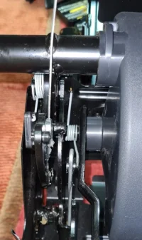

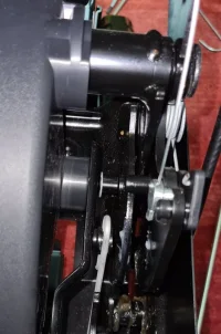

In my case, one side of the catch release the other won't, because you can see in the first picture, there is a spring tensioner missing.
Interesting. I'll have another look at mine as the focus was on jamming versus missing pieces!
I would assume (because I honestly don't know) that the springs would be to keep it locked?
