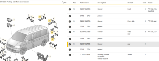

Does anyone know the part number for the rear parking sensors on a t6.1? Are they all the. Same sensor? Same as the t6 ones? I can’t seem to find the right part number for them!! Thanks!
The main 4 are the same on the rear but if you have side/park assist the 2 extras on the side are different
5Q0919275B

Cheers Pauly!!! I’m wanting black for a commercial bumper so I take it it’s the part number you have given me?
not sure, it only listed the GRU one ?

Hi @Pauly
just had someone reverse into my rear bumper and it needs to be replaced, I can get one with 6 sensor holes in my paint color, but I will have to put dummy sensors in the sides. Could you show me the part numbers on this picture of numbers 7, 8 +11, please?

Did you manage to get the part numbers needed. Any idea of cost?
Same situation! Thanks.

I did get it sorted, I only had to buy the sensor mounts as my sensors were ok. I cannot remember the cost of parts wasn't much from TPS
