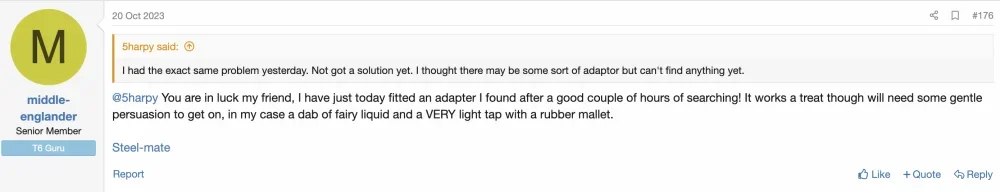

Which mount did you use and where did you get it from if you don't mind me asking,? I'm in the same situation
Thanks JB26413. I now have the windscreen fitting thats needed with the Wolfbox dash cam. The new dashcam is 12” long so, as you say, it’ll easily cover that extra lump. I might do that if my other options don't work. My first option is a friend with a 3D printer is going to make larger ball for the original bracket. My next is a bit more radical and involves cutting the ball off each fitting and welding or glueing the bigger one on VWs bracket. Welding cast fittings is difficult so I might try the weld glue. They boast it’s as good as…but we’ll see. This is still a kind of R&D job and is work in progress. Updates as they happen.
Same here, hoping someone found a solution and can share.
@middle-englander did the legwork and found this adapter by Steelmate. It's not quite a perfect fit bit for the Wolfbox extension as it's female wedge shaped fitting. The extension for the back of the mirror goes down far to jam nicely and be a good, firm fitting.
