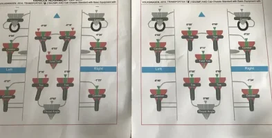

IMG_6369.JPGIMG_6368.JPG IMG_6366.JPG IMG_6367.JPG I found this a few months back and reset mine as close as I could to this, I dropped mine about 70mm and reset this new height as my new unladen weight toe in. I couldn't get exactly the reading at unladen but got close
Exactly what is needed. Someone that has actually done the adjustments.
So, to everyone that has/is lowering.. IT CAN BE DONE.

@Amped , note they used a 2014 data set to a chassis cab!
