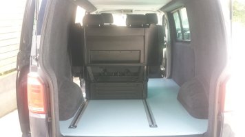

So its a genuine used Cali roof and rails - resprayed to match bodywork and fitted with new canvas. Looks absolutely fantastic and is operated either by interior switch or remote. Great that it has the Cali interior roof with tambour style hatch. Cali seat is 116cm max width - reupholstered to match Samora fronts now on swivel bases. Fitted on the n/s as my van was a Kombi with n/s single slider. Bed board to fit into the flush rails is not made yet but I'll do that and therefore make the rear seat bed arrangement to my requirements .... scope for well over 2m length if you need it.... so long as you don't fit furniture which protrudes too far. I would recommend that you speak to Richard at Kernow Conversions down here in Cornwall for all the roof, seating, flooring, lining and leccy work.

Cali seat comes with a deep drawer at the front and a jack storage box at the rear.... so two instant fixes which are especially helpful when no furniture units are fitted. Cut that horrid jack mount off the rear n/s wheel arch before carpet lining!

My new floor with California rails was fitted to a factory Kombi ... I understand the rubber flooring was left largely in situ to provide much needed sound deadening. New deeper side step was fitted to accomodate 15mm rise.

I think this is what I'm looking to do. Your rails look pretty much flush with floor. So they're seats taken from a California and rails fitted? Are the seats new or second hand? Who fitted the rails? Thanks
Rails are either genuine California or Caravelle. Mine have chrome lashing point ends fitted which I believe are a Caravelle spec. Rear seat is California reupholstered in Simora fabric to match fronts. Plastic panels sprayed black as Cali fabrics and plastic panel color schemes are annoyingly different to those used in other vans. New flooring with rails and rear seat were supplied and fitted by Kernow Conversions. Among many other things! Not sure if they're still doing conversions .... possibly only VW interior parts such as the seats. Might be able to make new floor with rails I suppose ... he owns an excellent template. You'll of course need a rear third section to make a full double bed with the Cali rear seat. Made my own which bolts and slides in the rails using some new steel legs for Cali rails bought from fleabay and then cut to a lower height ... again with a matching Simora cushion i had made by an upholsterer to my pattern. Great but expensive to do! Hope you find what u r looking for.
