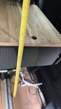

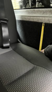

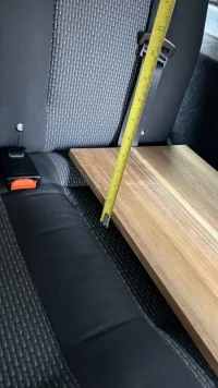

My Reimo Variotech 3000
Floor to top of seat cushion (under the knee) 484mm
The lowest part of seat pad is 25mm lower than the knee roll
Seat pad (lowest) to underside of bed board in roof 915
Seat pad lowest to top of wall panel under the window ( which should be a fixed reference regardless of roof design) 205
So looks like about 25mm difference in head height to roof bed, and 66mm difference in distance from seat front to floor.
