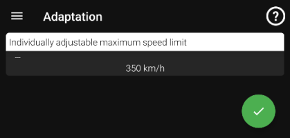

Try the following:
Control units > Engine > Adaptation > in there is a channel something like "Adjustable maximum speed limit"
change it to e.g. 300 km/h (factory value) press and hold "write" button.
Let us know if it's then limited to 300 km/h ;)

Thanks, seems easy enough - I will give it a go and report back. Perhaps though, if I set it to 1080000000 it might be capable of time travel?
I finally picked up the van this afternoon, did as you suggested and it worked perfectly. Thanks for the input.
