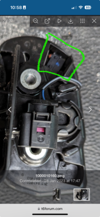

So a bit of an update and maybe some info to help people.
The reason the door wasn't closing (non electric) was the rear door catch mechanism was corroded and not engaging.
I found the part number 7E0843603D. The D stands for it having a micro switch.
Looked everywhere online and had new prices over £130
So a bit of eBay later I found the same part number but off a VW Caddy 1.6 2010-2015 for £20. Bought it and gave it a go.
Fits perfect and problem solved.
Hi. Was it an easy fit? Is there a wire connection for the micro switch? Do you know if this is for the open door display? Cheers
It was easy to do. There is an electrical connection which I think maybe does the door open indicator tho I'm not on this. It's two spline bolts, an electrical connection and a cable
