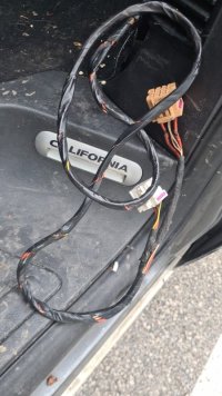

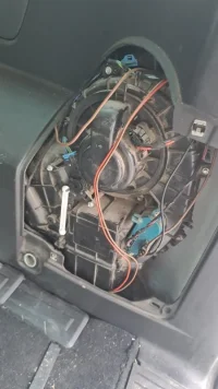

I have everything installed with original parts... blower, pipes connected to the front. But I don't have place to connect blower. All my cables are under the front seat..... But no place to plug in.... Is there a chance to turn on blower.... ?
