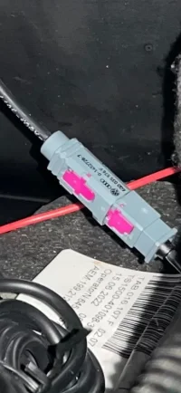

When I had this fault was the purple connection under the drivers seat. In that case, it was swarf from the poptop install.
I have a had quick look and cannot see a connector similar to that. But there is a white ducted channel that looks like the converters have put in. I think I’ll chance my arm at my local dealer and see if they’l look at it.
