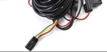

I did think about that but the pins are tiny and not sure how I would go about getting them out. I do have some pin removal tools though.
This is the small connector.
