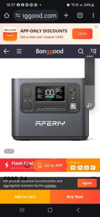

is it going to cause any problems if i hook up the afferiy 2400 battery power pack to charge the leisure battery and to use the 240 volt plugs inside the camper. i have plugged it in to the ehu everything seems to work ok it's charging the leisure battery and i can use the 240 plug sockets in the camper the fridge works ok. also does anyone know if i can use the solar panels for the affery while still hooked up to the ehu and charging the leisure battery.

This battery pack?
It shows 2400w inverter, so should be good running the EHU on the van, and charge via the vans charger ok.
But what reversed polarity light comes on?
The PV on the battery pack?... Is so then the panels are wired into the battery box reversed?
