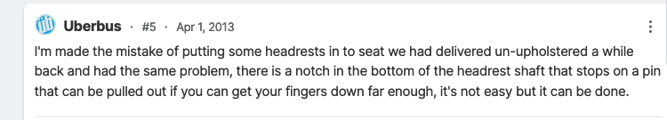

Hello - can anyone tell me how to remove the RIB headrests? Need to get them off to fit seat covers...doesnt seem to be any obvious clip as with other car headrests.
If i recall correctly, you need to release the headrest from inside the seat, is there not a velcro fixing for the seat cover under the headrest that you lift up?
Nope. Everything is nicely stitched. There is a concealed zip across the seat base. Will see whether that provides any easy access, otherwise will leave alone.
Hi - I have searched all over for an answer to this. This is what I've come up with. Surely it can't be impossible to ever change the covers on your camper? Seems crazy.
